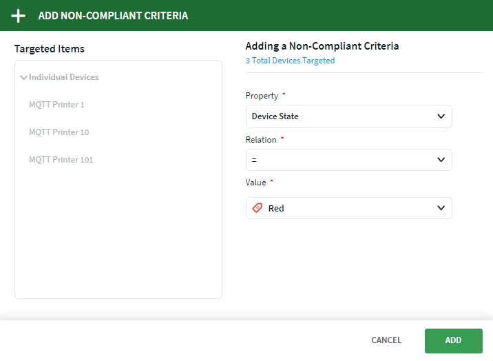

In the Add Non-Compliant Criteria panel, specify the non-compliant criteria as shown below and select the Add button.
Note: You can add more non-compliant criteria to create a more complex compliance rule. -
Add another non-compliant criteria, similar to the one just created, but
specify State = Red instead of
Yellow
Select Finish to complete the new rule.
Note: When there is more than one non-compliant criteria in a compliance policy, a drop-down list containing AND and OR appears. To cause the compliance policy to detect non-compliance when any of the non-compliance criteria apply, select OR. To cause the compliance policy to detect non-compliance when all non-compliant criteria apply, select AND. When selecting AND or OR, the selection automatically applies to all non-compliant criteria. -

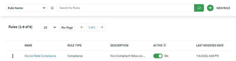

The newly created rule displays in the Rules view.
Note: Newly created rules are active by default.
