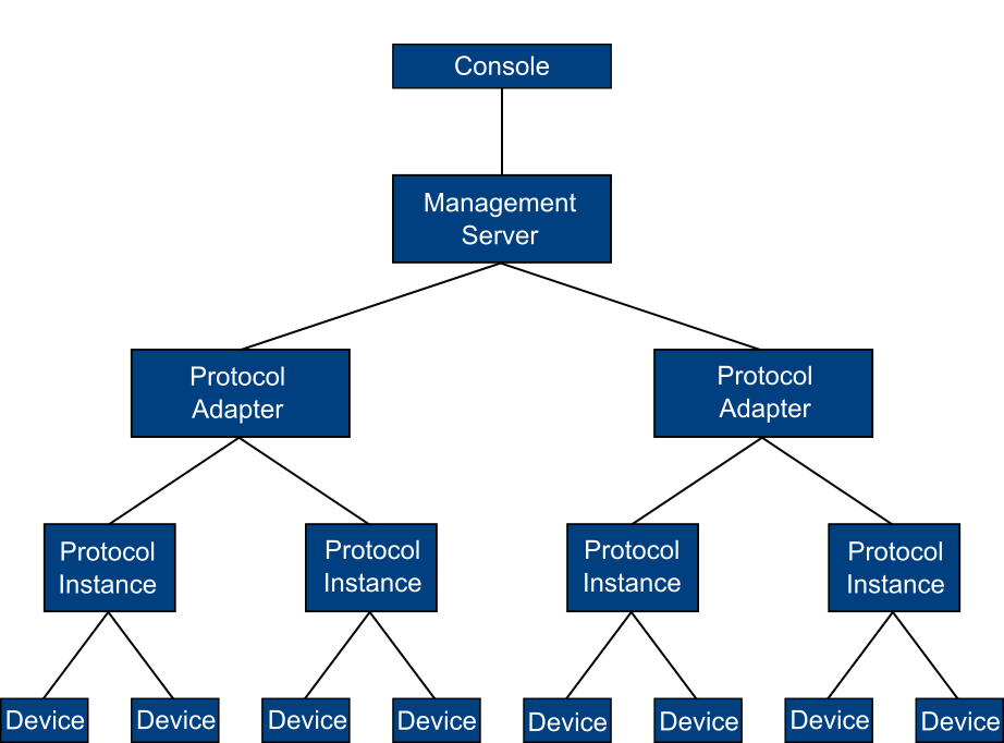

For a visual representation of how the components relate to each other, see SOTI Connect components below.

The console acts as the front end for the SOTI Connect management server. It displays the information about devices that is held by the management server. Actions that you perform on devices in the console are passed to the management server by means of API calls.

The management server serves as the back end for the console. When you perform device actions in the console, they are sent to the management server for execution. Information about devices is maintained by the management server and communicated to the console for display.
As well, the management server communicates with the protocol adapters that are registered with the SOTI Connect system.
Protocol Adapter
A protocol adapter communicates with the management server it is connected to (using JSON messages defined in a protocol definition) and with devices (using the device-specific protocol).
