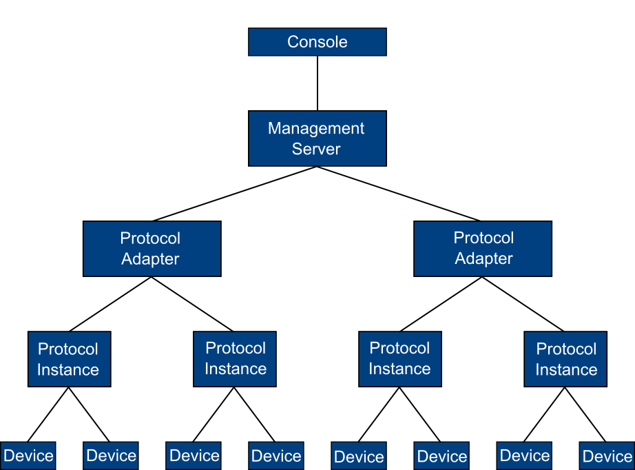

A SOTI Connect system includes the following components: These components work together to enable you to manage IoT devices.
For a visual representation of how the components relate to each other, see SOTI Connect components below.

Figure 1: SOTI Connect components
Note: Some protocol instances are actually the devices themselves.
