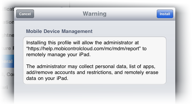

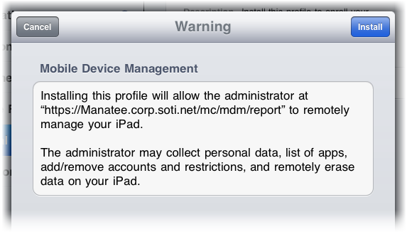

  3. Warning
    When you tap Install Now, your iOS device will show you a warning message giving you a brief explanation on what the MobiControl Device Profile will do.
    Warning Message

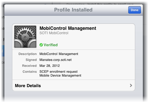

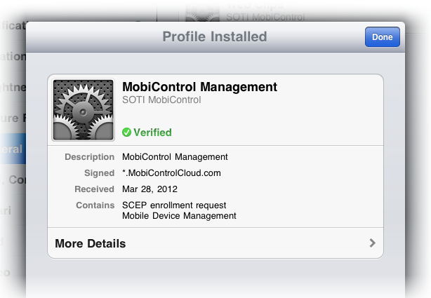

  4. Profile Installed
    After you tapped Install on the warning panel, the MobiControl profile will now be installed. It goes through multiple steps which are automatic and require no user interaction. Once the profile is installed all that is left to do is tap done.
    MobiControl iOS profile Installed
After the profile has been installed you will then be brought back to Safari. You can now see in the MobiControl Web Console that your iOS device is fully enrolled.

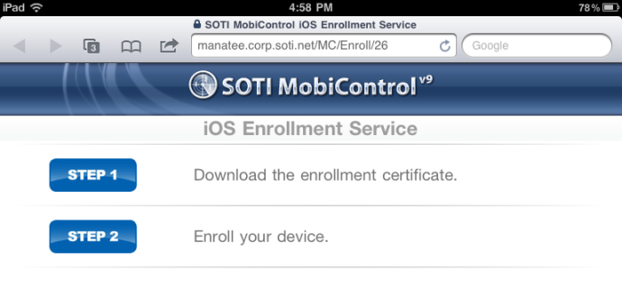

  1. Going to the iOS Enrollment Service Web Page

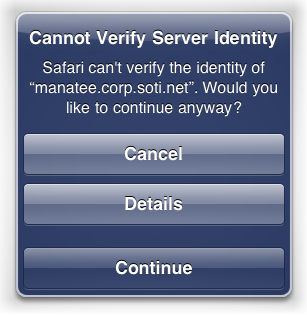

    When you successfully enroll your iOS device through the Device Agent or directly go to Safari and enroll agentless, a pop up will appear stating that it cannot verify the server identity. Tap continue to view the iOS Enrollment Service web page.
    Cannot Verify Server Identify

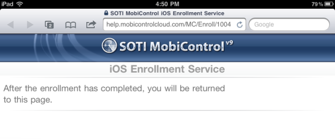

    The iOS Enrollment Service Web Page

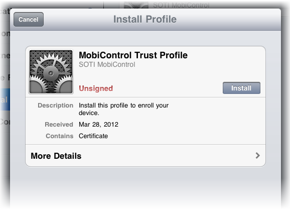

  2. Download the MobiControl Trust Certificate

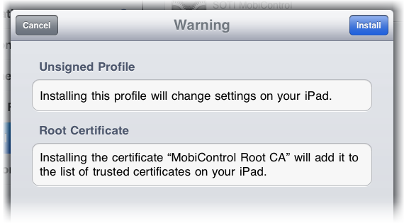

    Tap Step 1 to begin downloading the MobiControl Trust Profile. This profile will install the MobiControl Root CA on your iOS device. This is implemented to verify the MobiControl Device Enrollment profile. Tap install to continue with the enrollment process.
    The MobiControl Trust Profile
    Install the MobiControl Trust Profile

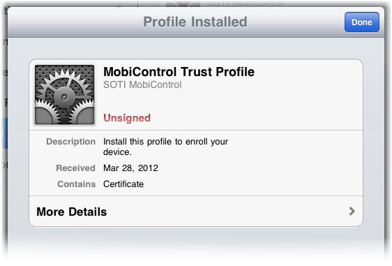

    Profile installed

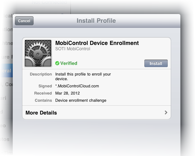

    After the MobiControl Trust Profile has been installed, you will be redirected back to Safari to continue the enrollment process. When you are returned back to Safari, tap Step 2 to download the Enrollment Certificate. The MobiControl Device Enrollment Profile will now be shown. Tap install then Install Now.

  4. Warning
    Warning Message
  5. Profile Installed
    MobiControl iOS Profile Installed
After the profile has been installed you will then be brought back to Safari. You can now see in the MobiControl Web Console, that your iOS device is fully enrolled.
