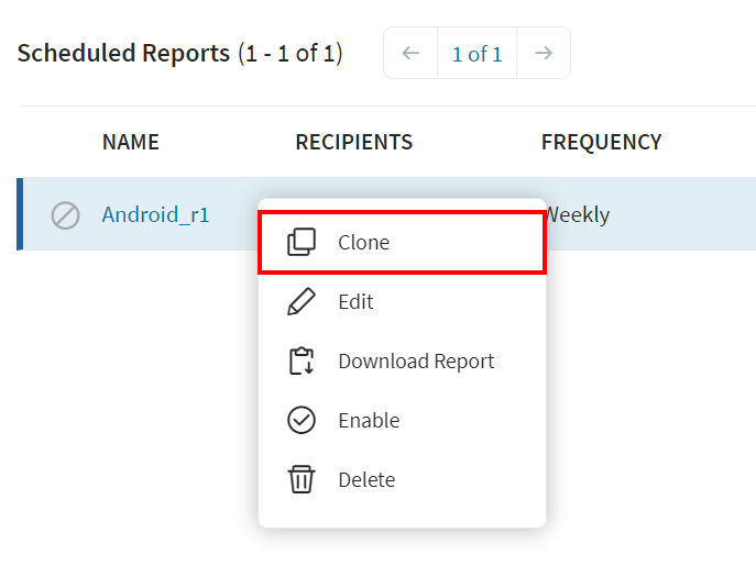

To create a copy of a report schedule:
- From the SOTI MobiControl web console main menu, select Reports.
In the left pane, select the report type under Report
Categories. The report details appear in the right pane.
Note: You can search the report you want by selecting Search. You can also filter the Report Categories by device family type.
In the right pane, right-click on the report schedule. Select
Clone.
A new copy of the Schedule Report wizard opens. - In the Schedule Report wizard, make the desired edits to the schedule - see Create/Edit Schedule for Report for more information about the tabs.
- Select Finish to save the schedule changes.
The new copy of the report schedule appears in the Schedule section.
