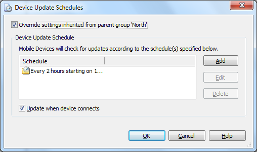

Device Update Schedules dialog box
The following table describes the Device Update Schedules dialog box:
Field Name Description
Add
Select Add to specify additional update intervals. The Schedule Entry dialog box will be displayed.
Example:
To sync a device twice a week, Monday at 06:00 and Friday at 19:00, create two weekly schedule entries.
Edit
Select Edit to modify an existing schedule entry. The Schedule Entry dialog box will be displayed.
Delete Select Delete to permanently remove an update schedule entry from the dialog box.
Update when device connects
Select this check box to have the device(s) check for updates whenever they connect to a Deployment Server, that is, at every transition from offline to online.
If this check box is not selected, the device(s) will only check for updates according to the schedule defined above.
