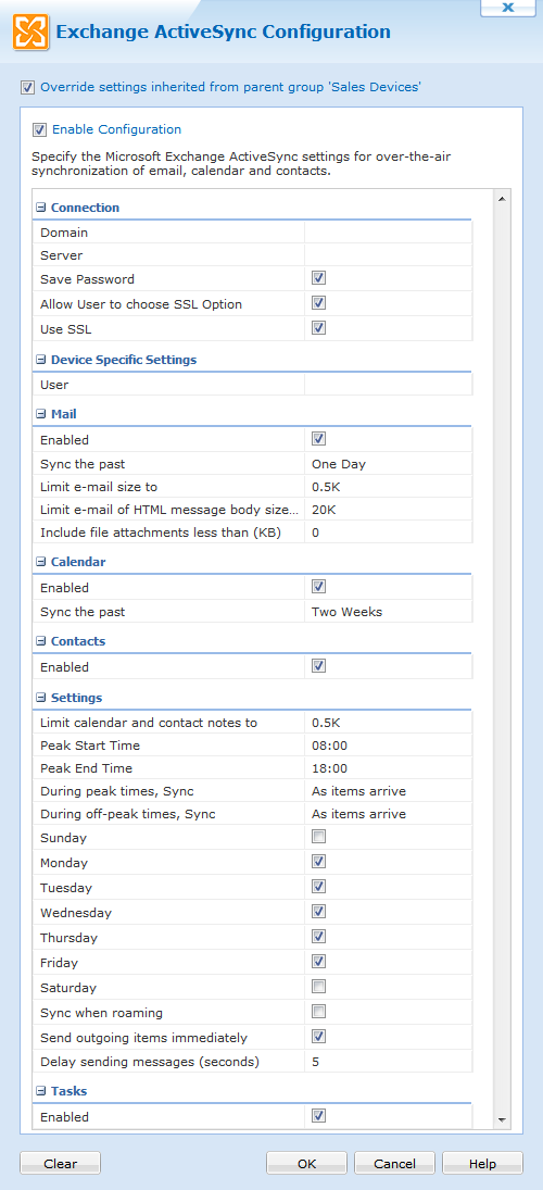

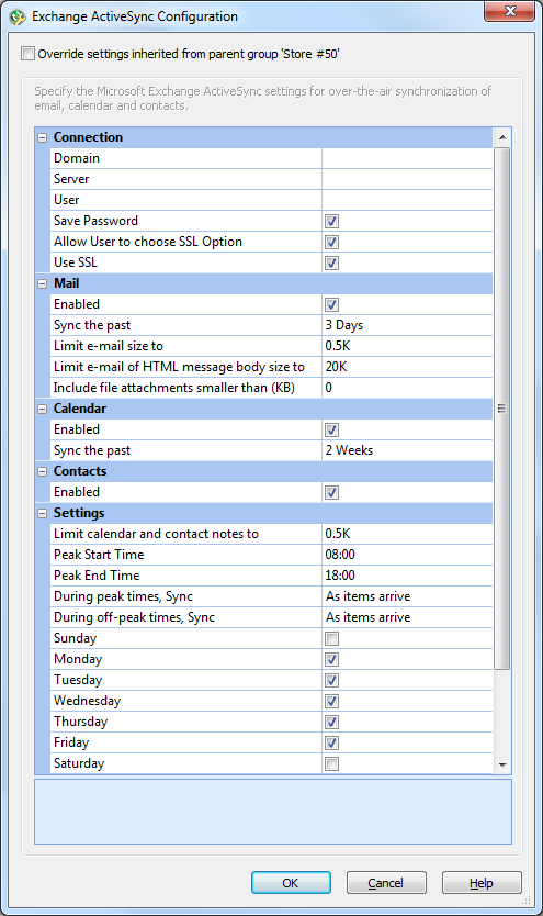

With MobiControl, you can now configure Microsoft Exchange ActiveSync settings for your mobile device. To arrive at this configuration menu, select the device or the group, right-click, select Configure Device(s), and click Exchange ActiveSync.
Connection Options
Field Name Description
Domain Enter the domain name of your organization.
Server Enter the server address of your organization.
User Enter the user name for your Exchange email account.
Save Password Check this box if you wish to have your password saved. If this box is unchecked, you will be asked to enter the password each time you perform synchronization. Also, this box must be checked for push email synchronization.
Allow User to use SSL Option This option allows the end user to select whether or not SSL is used for communication with the Exchange server.
Use SSL This option enables the SSL protection on the connection.
Mail Options
Enabled This option will enable email synchronization.
Sync the past This option will synchronize all email entries for the past up to the specified number of days.
Limit e-mail size to This option will control the maximum amount of data in the email message that can be used during email synchronization.
Include file attachment size smaller than (KB) Any email with attachments smaller than the specified size, will be downloaded to the device upon synchronization.
Calendar Options
Enabled This option will enable calendar synchronization.
Sync the past This option will synchronize all calendar entries for the past up to the specified number of days.
Contacts Options
Enabled This option will enable synchronization of contacts.
Settings Options
Limit Calendar and Contact Notes to This option will control the maximum amount of data that can be used during calendar notes and contacts notes synchronization.
Peak Start Time This time specifies the beginning of the peak service for peak days.
Peak End Time This time specifies the end of the peak service for peak days.
During Peak Times, Sync This option specifies how frequently synchronization should occur during peak times.
During Off-Peak Times, sync This option specifies how frequently synchronization should occur during off-peak times.
Sun / Mon / Tue / Wed / Thu / Fri / Sat Select the days you want to include in your peak-time synchronization schedule
Sync when roaming This option will allow automatic synchronization for the mobile device even when it is using a roaming data service.
Send outgoing items immediately When sending items from the mobile device, you have a choice to send it immediately or after a delay. This option controls this setting to send items immediately or after a delay.
Delay sending messages (seconds) This option specifies the time interval for the delay when sending an email from the mobile device
Tasks Options
Enabled This option will enable synchronization of tasks.
