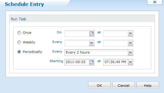

Schedule Entry
The Schedule Entry dialog box allows you to specify schedule entries as one-time or periodic events.
Field Name Description
Once Device will check for file synchronization once at the specified date and time.
Weekly Device will check for file synchronization  once a week, on a specified day and time.
Periodically Device will check for file synchronization periodically at the specified interval from the set, start date-time.
