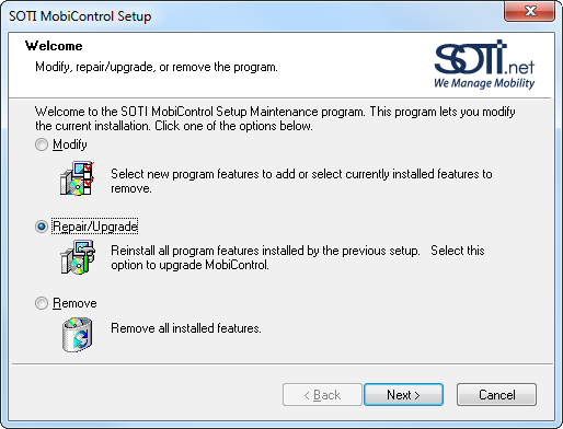

  4. Run the updated Setup program.
    Select the Repair/Upgrade option and follow the setup instructions in the Setup Wizard. This must be ran on the Deployment Server prior to updating any of the MobiControl Manager consoles.

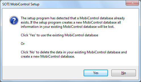

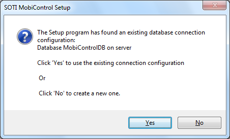

  5. In the dialog box about the existing database connection configuration, select Yes.
    The next dialog box prompts for keeping the old database or getting rid of it and creating a new one. Since we are upgrading, we want to keep the existing database, so select Yes.

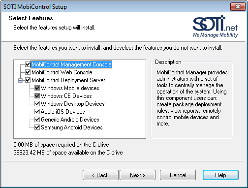

    The next dialog box gives you the option to install MobiControl Web Console as well as support for Apple iOS or Google Android Devices.

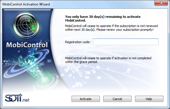

    Another dialog box will appear only if you have a registration code that is an older format. To exchange it and get a new registration code, you must contact us and provide your existing registration code followed by the company name and the person to whom the product is licensed.

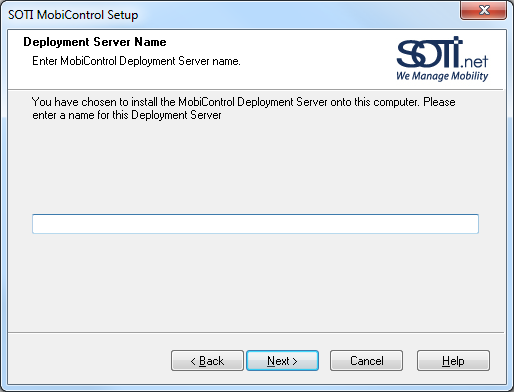

  7. Enter Deployment Server information.
    A box will be pre-filled with your existing Deployment Server name. To keep the same name, select Next.

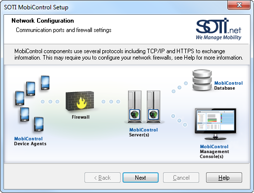

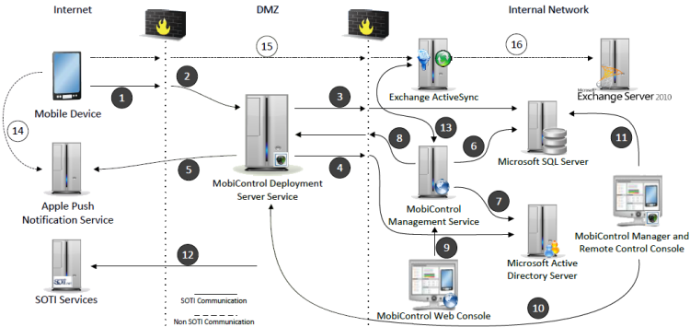

  8. Network Configuration.
    The Network Configuration screen gives you a high level overview of the MobiControl connection architecture.
    #Network Connection DetailsProtocolPort(s)
    1MobiControl Device Agent connects to MobiControl Server via firewall/gatewayBinary/HTTPS5494/443
    2Firewall/Gateway port forwards traffic on designated inbound ports to ports on host computer running MobiControl ServerBinary5494/443
    3MobiControl Server connects to Microsoft SQL ServerBinary1433
    4MobiControl Server connects to Microsoft Active Directory ServerLDAPS636
    5MobiControl Server connects to Apple Push Notification Service (APNS) for communication/feedbackBinary2196/2195
    6MobiControl Web Console connects to Microsoft SQL ServerBinary1433
    7MobiControl Web Console connects to Microsoft Active Directory ServerLDAP389
    8MobiControl Management Service connects to MobiControl ServerBinary5495/5494
    9Web browser connects to MobiControl Management ServiceHTTP(S)443
    10MobiControl Manager and Remote Control Consoles connect to MobiControl ServerBinary5494
    11MobiControl Manager connects to Microsoft SQL ServerBinary1433
    12MobiControl Manager, Server and Web Console connect to SOTI Services (Activation, Agent Builder, Enrollment, Location, Messaging, Skins)HTTP(S)/Binary443/80
    13Exchange Filter connects to Exchange Filter Service (running with Management Service) Binary443
    14Apple iOS devices connect to Apple Push Notification Service (APNS)Binary5223
    15Device connects to Exchange ActiveSync Server (EAS) to retrieve emailBinary443
    16Exchange ActiveSync Server communicates with Exchange ServerBinary443

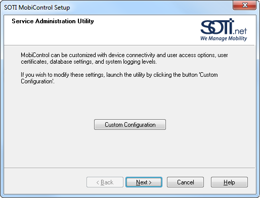

  9. Custom Configuration
    The Custom Configuration button provides access to the MobiControl Administration Utility.

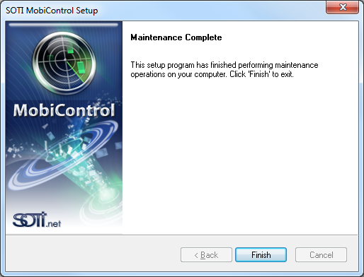

  10. Complete the Installation.
    Repeat steps 4-7 on each computer that has MobiControl Manager, Package Studio or a Deployment Server installed.

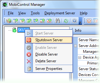

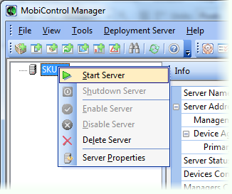

  1. Verify the Deployment Servers have restarted.
    Click the Deployment Servers view (tab) in the MobiControl Manager to verify the Deployment Servers are active. If a server is not running, you can start it by right-clicking on the Deployment Server icon and selecting Start Server. If the Deployment Server is located on a separate host from that on which you are running the MobiControl Manager, you will have to log in to that host (e.g. Windows Remote Desktop) and re-start the MobiControl Deployment Server by opening the Control Panel, clicking Administrative, and clicking Services.

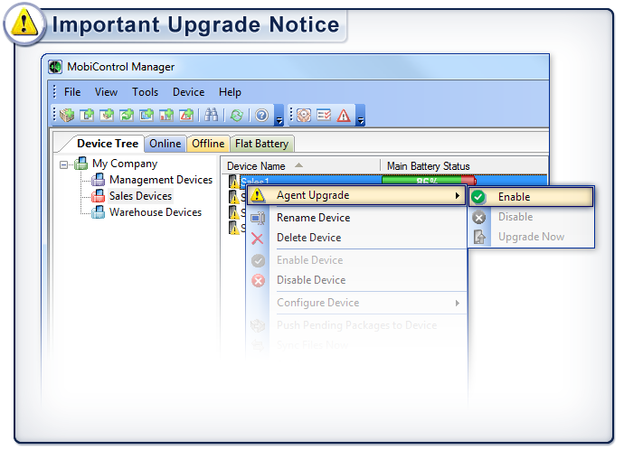

    At this point, all the devices in the device tree will appear with a warning sign. This is an indication that agent upgrade must be enabled in order for the automatic upgrade of the Device Agent devices to proceed. Automatic upgrade is not enabled by default so that agent upgrade can be performed gradually. This allows you to upgrade a controlled set of devices and verify the new agent performs well before upgrading the agents of all your devices.
    For example, if after enabling for a few test devices, problems are detected with the new agent, the upgrade can be rolled back, and the majority of the devices will avoid the failed upgrade.

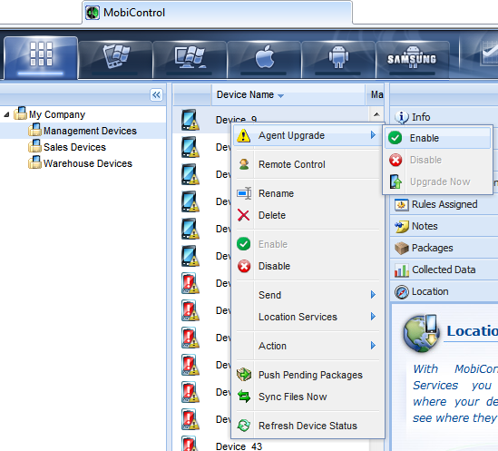

  3. Enable upgrade for one device.
    Right-click on a device, select Agent Upgrade, and click Enable. If the device is already online, select Upgrade Now. If the device is not yet online, there is no need to select Upgrade Now, as the new agent will be automatically delivered upon connection to the Deployment Server when upgrade is enabled.

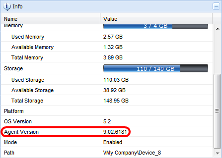

  5. Verify the build number.
  6. When the device returns online, verify the build number by selecting the device and looking at the Info panel. If there is any conflict with the version you have installed (compare to the version information in the Manager's about window), and the version currently on the device, or if there are any error messages in the log panel, please contact us.
