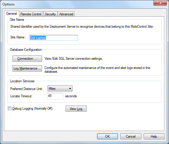

General
This page allows you to change the MobiControl site name, and the MobiControl
database connection.
General options tab
The table below describes the fields in the General Options Page.
| Field Name |
Description |
| MobiControl Site Name |
In situations where there are multiple MobiControl installations in a single
facility, this field can be set to a unique name for each installation. In this
way, MobiControl Deployment Servers from
one installation will not respond to devices that are being managed by another
installation.
The site name configured here gets injected into the Device Agent
software created by a particular installation. When a MobiControl Device Agent
connects to a
Deployment Server and the site name supplied by the
device does not match, the connection is terminated and then logged. The site
name is also used by mobile devices to automatically discover the new IP address
of a
Deployment Server when the Deployment Server
address is changed.
| Configure Database
Connection |
The MobiControl database
connection is configured by the installation program but can be modified by
clicking on this button. Please see the Database Configuration page for more information
about configuring the database connection. |
| Log Maintenance |
This tool brings up the
options for logs maintenance. Please see the Log Maintenance Options page. |
| Location Services |
The Preferred Distance Unit
allows you to change the unit of speed that is displayed when tracking or
locating a device in the Location panel. The Collected Data panel will continue
to show speed in knots regardless of this setting.
Locate Timeout defines the amount of time, in seconds, that MobiControl should
wait for a response from the GPS on the device. The default value is 45 seconds. |
| Debug Logging (normally off) |
If this box is checked, the
MobiControl Manager will start logging its activity into the MCManager.log file in the program directory. This setting should only be
enabled when tracking problems and working with SOTI support staff. |

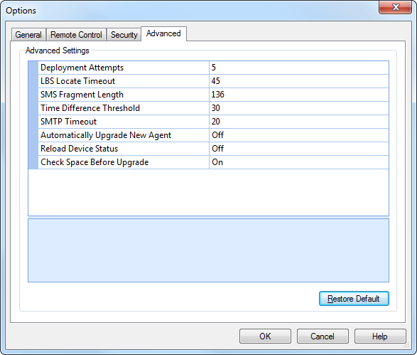

Advanced Settings
The Advanced Settings tab provides control and configuration for various undetected settings within the MobiControl management console.
Advanced Options tab
The table below describes the fields in the Advanced Options Page.
| Field Name |
Description |
| MobiControl Deployment Attempts |
This entry determines the maximum number of attempts to deploy a package.
| LBS Locate Timeout |
This entry specifies the length of time the manager should give devices to satisfy locate and track requests (in seconds). Note that a device that times out while tracking does not leave tracking mode. This setting is the length of time for which it will turn on the GPS radio. Thus, the setting has no effect on devices tracked with the 'leave GPS radio on continuously' option checked. |
| SMS Fragment Length |
This entry determines the length of the SMS messages sent. The default value for this entry is 136. Some wireless carriers may enforce a shorter SMS character limit. In this case, the SMS fragment length will need to be adjusted to be able to correctly send scripts over SMS. |
| Time Difference Threshold |
This entry determines the threshold value in minutes for the Deployment Server to compare its time with the devices.
When a device connects, MobiControl gets its time (UTC) from a snap-shot and compares it with the date/time of the Deployment Server (UTC). If the time difference is found to be more/less than x minutes - where x minutes is specified in this field then a warning LOG message is added to the InstallLog for the specified device. |
| SMTP Timeout |
The timeout value for the SMTP server. |
| Automatically Upgrade New Agent |
This entry determines if the system will upgrade any newly added devices using an old version of the device agent. |
| Reload Device Status |
Setting this entry to 'On' will instruct the Deployment Server to broadcast to all connected Managers to reload device information from the database when devices come online, otherwise devices will be updated using the information delivered by the Deployment Server. |
| Check Space Before Upgrade |
