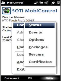

This menu contains general Device Agent information and the agent connection button.
From this Main Applet page, you can access the other menu windows by clicking
the Menu button on the bottom right corner and then selecting Configuration.

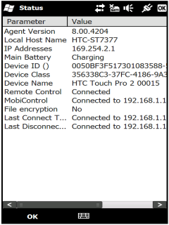

Status Menu
This menu displays the status of the.
| Option |
Description |
| Agent Version |
This displays the version of the
Device Agent running, in format of
(major version).(minor version).(build number). |
| IP Addresses |
These are the IP address(es)
the device has been configured, either static IP addresses or DHCP IP addresses. |
| MAC Address |
This is the hardware MAC
(Media Access Control) address of the device's network adapter. |
| Network (SSID) |
This field shows the SSID of
the wireless network to which the device is connected (if applicable). |
| Main Battery |
This field displays the
devices battery status. |
| Device ID |
This field contains the
unique identifier of the device in MobiControl system. The Device Agent
automatically populates this field. |
| Device Name |
This field shows the current
device name used by MobiControl. MobiControl names devices based on the naming
convention chosen when the agent was configured using the Device Agent
configuration tool. |
| Remote Control |
status of the remote control connection. |
| MobiControl
status of the MobiControl server connection. |
| Last Connect Time |
This displays the last time
the device was connected to the MobiControl server. |

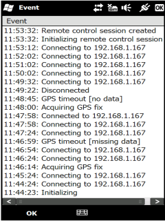

Events Menu
The Events Menu displays all the recent events that occurred on the device.

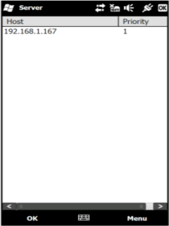

Packages MenuThe Packages Menu displays the information of all the installed packages. Servers MenuThe Servers menu allows all the Deployment Server
options to be configured. | Option | Description |
| Host | The host/IP and port number of the Deployment Server | | Priority | The priority of the servers over other servers | | Add | Adds an IP address/port and sets the priority of a new Deployment Server | | Edit | Allows the modification of an already added Deployment Server | | Del | Deletes the selected Deployment Server entry | | Test | Tests the connection between the device and the selected Deployment Server |
The agent uses the server list to find out and connect to the Deployment Server. It starts from the server which has the highest priority. If failed, then it
randomly picks up another server which has the same priority and retries. If all
the servers which have the same priority are not available, then the agent tries
the servers which have a lower priority, and repeats these steps until a Deployment Server
is successfully connected. Number one is the highest priority, number one is the second highest priority, …,
and number 5 is the lowest priority. When making changes to the server list,
keep in mind that the priority numbers of the servers should be consecutive.

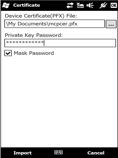

The user must specify the location of the file to be imported, and then provide
the password that was entered when the .pfx file was
originally exported from MobiControl. Certificate Menu (Windows Mobile 5, 6.x and Windows PC
devices only)The Certificate Menu allows the user to import a .pfx
file that contains a certificate and private key that enables it to communicate
with the Deployment Server using the SSL protocol. |
