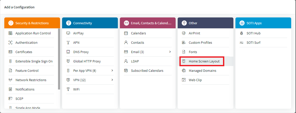

Add a new configuration to a new or existing iOS profile. From the
Configurations tab, select Home Screen
Layout.
